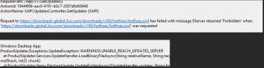

Hi, I upgraded my 3CX Server on-premises to version 18.0 build 939, but I can't upgrade the Windows Desktop App. When I try, occurred these log errors and if I try the access the URL address, showed this block page.

Hi @Alejandro_3CX, I can still see the download in management console, and if I try download, occurred the error logs in server and the access to URL address is blocked, but this block is not mine.
ok, I see, there are reasons for this, the system can not connect to our servers or you are missing any permission on the folders used to save the installer once downloaded.

There is no issue to download the app, this is an on premise installation, in your particular case as mentioned before there are two reason for this, there is a connection issue to the download servers or there is any permission error to save the file on the server.
On premise installation the admin should take care of the network, OS, server.
Perfect, I thinked this error is caused by 3CX and not by me, because this URL address, that show the error "Forbidden", is not accessed by any devices in differents networks.
