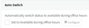

To exclude extensions from auto switching, go into Extensions select all extensions you want to exclude, click on Edit and go into "Forwarding Rules". Scroll down a bit and uncheck the option that reads "Auto Switch" as seen below:

Thanks a lot for your support. That helped me solve the problem. I had the whole scenario established. The only thing that didn't work is to keep the extensions always available. And that was the "Auto Switch" setting, which had to be completely removed (untick).
