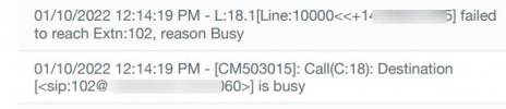

- We created a new USER/EXT and added new Yealink phone and did this quick test and captured log output. see attached. To restate the issue: The inbound caller hears the call go strait to vmail (for any extension we test). The receiving end hears the device ring and can pickup but hears nothing.
01/10/2022 12:14:19 PM - L:18.1[Line:10000<<+1415XXXXXXX] failed
to reach Extn:102, reason Busy
01/10/2022 12:14:19 PM - [CM503015]: Call(C:18): Destination
[<sip:[email protected]:5060>] is busy
So...for some reason, 3CX sees the extension as being busy.
Exactly, we're just discussing here too. We're trying to figure out what could be trigger that. The extensions are not set to busy and it's a new vanilla setup for the most part. Any thoughts on what also might trigger a busy indicator on an otherwise basic cloud configuration?

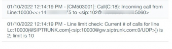

I checked the log a bit and can actually see two calls coming in, both routed to extension 102 which would explain why it comes up as busy:
1st call(C17) comes in:
2nd call(c18) comes in 4 seconds later:
2nd call (C18) sees 102 as busy:
Both C17 and C18 calls are still active later on:
To test if this is what's happening , try enabling "allow multiple calls" on the extension to check if it stops going to voicemail. If it does stop, you won't be out of the woods yet because you'll still need to figure out why you got two incoming calls for what should've been one. For that you might have to dig deeper or reach out to the provider.

All, this one is resolved. The root issue was related to the SIP gateway. For some reason this trunk was stuck on GW2 (a failover backup) at SipTrunk and it was causing the duplicate call issues. Their great support team helped us resolve quickly moving the trunk onto GW1. We tested again and all extensions ring now and the call is not sent direct to voice mail.
So, there were no issues with 3CX config or the phone/devices. I hope this is helpful for others.
