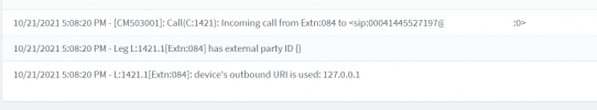

Hi YianniscH, i´m really glad for your fast answer.......but the logs are a little bit cryptic to me......how i can understand the key in the log to understand the outbound rule that is using?
For the outbound rule, you will a line like this:
You will then scroll up and search for an Invite message towards the provider and check the From value. That is your outbound caller ID.
It will look something like this:
seems to be all fine....
Is +49 the country code used in your location, or by your provider? The above log seems to show caller ID with no country code, and calls using rule CH Out. Could it be that the country code is currently being added by your provider?
