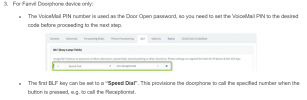

Hi Guys,
I've got a fanvil i30 on the latest (as of today) FW and have a few questions.
- Can I set up multiple speed dials? If so, how?
- Can I configure the Function key for more than 1 destination?
- Can I turn off the beep when pressing keys?
thanks.
The to all is most likely yes outside of 3CX. But for that you would need to refer to the manual or ask Fanvil
Via 3CX you can mainly program two of the most basic functions
The rest you can do manually from its own UI
This will explain why my code wasnt working this morning as it auto prov'd.
I probably should have read the entire document >_<
I will see if our supplier can tell us if the beeps can be turned off.
I would take the time to study the manual, it has a lot of useful information regarding a number of things (code/card access, camera streaming, door lock switch types, etc). I think you can control the volume of the keypad independently from the speaker/ringer
Ah thats great!
thanks for taking the time to locate that.
