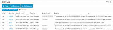

Please see picture for error message. I'm getting this constantly, multiple times a day but it's completely random. Sometimes a few phone will go down, sometimes all, but the Web client / SBC + Grandstream HT802 has no problem at all.
I checked the Event Log but couldn't find anything useful. This is the Event Log for today, but my ext 12 is down as of now.
This only started to happen after the V20 upgrade, I have not changed any provisioning method. FYI I did try to "Delete Phone", "Reset Phone to Factory" and then "Reprovision" but it didn't help.
