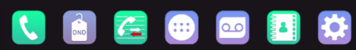

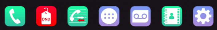

If you notice the screen of the device you will see there is a visual indicator on the DND icon
X7A FW2.2.0.166 shown above
Hi JohnS,
I have the row of icons exactly as per shown above however pressing the purple DND icon does not toggle between purple and red. It is always purple even though extension status in 3CX toggles on and off when you press it.
