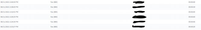

Still failing to send and I keep getting a "User Busy" on my fax machine. I see the fax hitting our hosted PBX, and I see it hitting our SIP provider. I am reaching out to them for more info.
