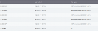

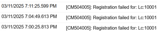

Hey everyone,
I’m running into an issue with a Flowroute SIP trunk on 3CX. The trunk keeps reporting that it's disconnecting and reconnecting intermittently, roughly every 5 min or so. When I check Flowroute, I notice multiple active SIP registrations, whereas other 3CX systems I manage do not show this behavior through flowroute. The 3CX Event log shows Event 4100 when this occurs. This particular network has a Checkpoint firewall, and I’m wondering if that could be a contributing factor. Has anyone else experienced similar issues? If so, what troubleshooting steps or firewall adjustments helped resolve it? This system is not live yet, so I have some flexibility to test. Any insights would be greatly appreciated! I have attached screenshots.

From your screenshots it looks like Flowroute is seeing the PBX coming from multiple ports so I am guessing port forwarding is not done correctly on the firewall. As a first step run the firewall checker on the PBX to see if everything passes successfully and take if from there.
