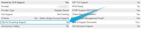

Just want to add that, if you're are using a 3CX Supported provider, you could check here if they support "CLIP no screening" which is essentially what you need. Just locate the provider from the list and check the following value:
