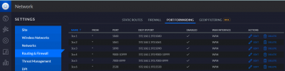

Firewall checker says port forwards are not working
Anyone got a clue?
Thanks in advance
All ports fail.
This router is a Ubiquiti Dream Machine
This is V18 currently in a virtualbox debian 64 VM for testing reasons the network connection is bridged
There is no other firewall on the network other than the fiber modem which is not configurable but should not be a hindrance
Just as a side note, you can remove the 3cx5 and 3cx6 rule
How did you install 3CX? could it be the firewall on the machine.
Ok managed to get it working but not sure how so can't tell you what I did all I did is port forward 5001 and it worked only one port didn't work and that was port 9308 most likely something else is using it but system doesn't seem to be affected
