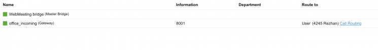

Hello Dears, i got free 4SC free, i have Elastics' i wan to changed with 3CX but during my test , after configuration everything its looks that i could not call out from PBX to outbound , which am using GOIP Gateway for GSM , incoming call working fine there as no issue , also i checked IPs for Internal connection between Gateway and 3CX server there was no issue , would you please let me know the issue relate license or there was misconfiguration ? Thank you, i would like to check every functions then purchase license for 16 SIM.

Dear Mr @Guillaume Bourgeois Thanks a lot the issue was from GOIP Side and its support only Trunk Gateway Mode with 3CX.
from SIP Gateway configuration.
