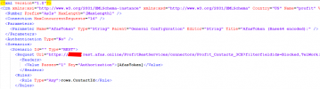

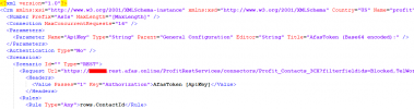

I created a template for a CRM connection to Afas Profit.
https://help.afas.nl/help/en/se/App_Cnr_Rest_Api.htm#o106269
The template was created using the wizard and then edited it in a text editor.
I edited it because I need to send the API Key as a header with a specific prefix (AfasToken).
So I could use the Basic Authentication as that would use the word Basic as Prefix and I need AfasToken
My template looks like this:

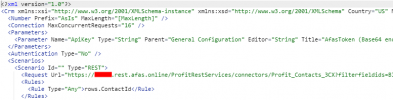

The problem I am having is that the Headers section is removed during the import into 3CX.
I see this when I use the 'Show Template' button:
What am I doing wrong here?
We're using 3CX 18.0 (Build 461)
