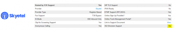

Skyetel is great, I'm going to ask them what they can do on their end. I've only used failover on their end in case of a PBX issue though, never in cases like this. I assumed once the PBX answered the call (even to a ring group) that a DNA rule wouldn't work. However, if all SC were in use (even for forwarding) then I would definitely need forwarding at the Skyetel level. Honestly, the business would do fine with 8SC as long as Skyetel could help me figure out diversion headers. That's a term I didn't know (although I do understand what it means), so thanks for that info so I can be more educated when asking for help!
Unfortunately Skyetel doesn't support 302 Diversion:
