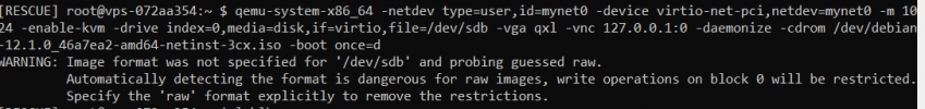

Can anyone help, getting an error
WARNING: Image format was not specified for '/dev/sdb' and probing guessed raw.
Automatically detecting the format is dangerous for raw images, write operations on block 0 will be restricted.
Specify the 'raw' format explicitly to remove the restrictions.
this after entering
qemu-system-x86_64 -netdev type=user,id=mynet0 -device virtio-net-pci,netdev=mynet0 -m 1024 -enable-kvm -drive index=0,media=disk,if=virtio,file=/dev/sdb -vga qxl -vnc 127.0.0.1:0 -daemonize -cdrom /dev/debian-12.1.0_46a7ea2-amd64-netinst-3cx.iso -boot once=d
Not an error, did you not see the screenshot in the step?
