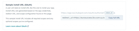

as soon as I copy and paste the sample install URL it throws the error. If you need any additional screenshots let me know
That's the problem, you are not following the guide. You don't need to do anything with that URL. Please check the guide, follow it to the letter, and you will have it working.
