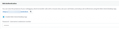

I have not been able to access my user for a few days. I have already enabled the web client but when I log in it does not log in. It gives no message. But when I try to log in from the app on my smartphone (scanning the qr), it gives me the message: "User is not allowed to log in", why? What else do I need to check to re-enable it. Until a few days ago it worked. I also did its regeneration but the problem continues.

When you're attempting to login, are you sure that you're navigating to the correct page? In the Management Console, Navigate to Users then click the link in the Web Authentication area. Ensure also that the "Enable Web Client/Desktop App" box is checked.

I have already done this
