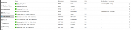

I upgraded to V20 recently but inbound calls don't pass my IVR
qhunter@zone7technologies
Apr 30, 2023
I upgraded to Version 20 some 2 days ago. But customers started complaining that they couldn't get to my office. I tried phoning myself and found that inbound calls don't pass the IVR.
After the IVR I am put on hold and then the call drops.

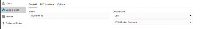

I changed the Destination route to my Extension but the calls are still going to the IVR
Drilling the IVR internally the calls are routed to there respective destination
