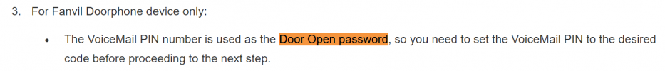

I have succesfully provisioned an i20s door phone. Everything works, except the remote door open code, which should be the voicemail password for the extension?
The EGS logs just say Remote Code Failed and the i20s makes its usual unhappy noise when we enter the voicemail password.
I have tried re-provisioning from phones page in 3cx, but nothing helps
Any thoughts please?

Correction: what we provision is the keypad password field aka <Local_Password>
I'm answering the call on another extension (sending over the phone) and trying to let the visitor in using the voicemail password.

However can just manually set the 'Calling' and 'Called' password fields in the EGS settings.

I have reviewed the template, and you are absolutely correct. What I originally said above was incorrect - The PIN that is provisioned on this model is only for they keypad, and always was this way.
The guide will be corrected to clarify this so that we do not cause any confusion in the future.
As for the Remote Open password, it must be provisioned manually by you via the fields mentioned earlier:
