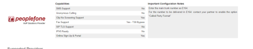

Startup is more static than a dedicated 3CX, so it would be the best way to use it as described in the 3CX Help section:
Reactions: TheodorosG_3CX
Hi @franzstuebi,
Please note that in StartUP you cannot use wildcards when configuring DIDs. They must be configured in E164 Format.
As mentioned by @Ritter Technologie, you will have to contact your provider in order to enable the option "Called Party Format".

Please note that Peoplefone now supports E164 with a leading +. That was not the case before. Since there is now support for E164 you need to enable it through the Peoplefone customer portal or have your Peoplefone partner enable it for you.
Wildcards are used when we are not sure about something and since Peoplefone now has the option for E164 wildcards are no longer necessary.
Please enable option "Called Party Format" for E164 and everything will work as they did.
This change/requirement is to assist you have a better experience. If multiple people use wildcard numbers and are not careful your calls might end routed elsewhere because someone decided to use 5 digit wildcards and they happen to also match your numbers. This is something you do not want. When we know exactly what number format the provider supports we will always opt for that.
Please note that Peoplefone now supported E164 with a leading +. That was not the case before. Since there is now support for E164 you need to enable it through the Peoplefone customer portal or have your Peoplefone partner enable it for you.
