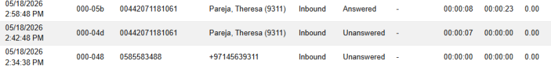

Hello Team,
Was hoping to get some assistance/guidance on a strange issue we appear to be having with certain Dubai Numbers being reachable.
When a certain carrier calls into the 3cx, it is coming up with the response that the 3cx isn't available. I can reach these specific extensions/numbers from a UK Number, and other numbers are also able to reach these numbers.The carrier so far has said it is an issue with the PBX, as they are seeing a not available coming back from the 3cx.But i can't see why it would be saying not available to a specific carrier/number range
I have attached an example image. The call from the UK Number goes through fine but the call from the number below it always fails.
Kind Regards,
Joe

The DID is set up in the SIP Trunk. I can reach it fine from a UK Number, and i can see other numbers have been able to reach it as well it just seems to be this range, there is nothing within the event logs that indicates any issue from today.

05/27/2026 12:00:33.158 PM[CDR] Call(C:241): CDR: Incoming params: cdr_id = '00000000-01dc-edc8-09f7-88640000023e' call_history_id = '00000000-01dc-edc8-09f7-6838000000f1' source_participant_id = '00000000-01dc-edc8-09f7-887f0000032e' source_entity_type = 'external_line' source_dn_type = 'provider' source_dn_number = '10001' source_dn_name = 'Dubai Audiocodes' source_participant_name = '058xxxxxxx' source_participant_phone_number = '+97xxxxxxxxxxx' source_participant_trunk_did = '+97xxxxxxxx' source_participant_is_incoming = 1 (i32) source_participant_is_already_connected = 0 (i32) source_participant_group_name = '' source_participant_billing_suffix = '' destination_participant_id = '00000000-01dc-edc8-09f7-88860000032f' destination_entity_type = 'inbound_routing' destination_dn_number = '+97xxxxxxxx' destination_dn_type = 'unknown' destination_dn_name = '' destination_participant_name = '' destination_participant_phone_number = '+97xxxxxxxxx' destination_participant_trunk_did = '' destination_participant_is_incoming = 0 (i32) destination_participant_is_already_connected = 0 (i32) destination_participant_group_name = '' destination_participant_billing_suffix = '' creation_method = 'call_init' creation_forward_reason = 'none' source_presentation = '05xxxxxxxxxxx' termination_reason = 'dst_participant_terminated' termination_reason_details = 'forward_all' terminated_by_participant_id = '00000000-01dc-edc8-09f7-88860000032f' cdr_started_at = '2026-05-27 11:00:33.073166' cdr_ended_at = '2026-05-27 11:00:33.158522'
05/27/2026 12:00:33.158 PMLsip{462724/241.1/UAS[Rejected&OfferReceived]} sends: SendResp Send 480/INVITE from 0.0.0.0:0 tid=ac33196655 Call-ID=[email protected]: SIP/2.0 480 Temporarily Unavailable Via: SIP/2.0/UDP 10.31.12.28:5060;branch=z9hG4bKac33196655 To: <sip:[email protected]>;tag=57f31918 From: <sip:[email protected];user=phone>;tag=1c1234781532 Call-ID: [email protected] CSeq: 1 INVITE Warning: 499 sigma.3cx.uk "Not available" Content-Length: 0
05/27/2026 12:00:33.158 PML:241.1[Line:10001<<++97xxxxxxxx{00000000-01dc-edc8-09f7-887f0000032e}] onReadyToSend: Send Send 480/INVITE from 0.0.0.0:0 tid=ac33196655 Call-ID=[email protected]: SIP/2.0 480 Temporarily Unavailable Via: SIP/2.0/UDP 10.31.12.28:5060;branch=z9hG4bKac33196655 To: <sip:[email protected]>;tag=57f31918 From: <sip:[email protected];user=phone>;tag=1c1234781532 Call-ID: [email protected] CSeq: 1 INVITE Warning: 499 sigma.3cx.uk "Not available" Content-Length: 0
05/27/2026 12:00:33.081 PMLsip{462724/241.1/UAS[SentProvisional&OfferReceived]} sends: SendResp Send 180/INVITE from 0.0.0.0:0 tid=ac33196655 Call-ID=[email protected]: SIP/2.0 180 Ringing Via: SIP/2.0/UDP 10.31.12.28:5060;branch=z9hG4bKac33196655 Contact: <sip:[email protected]:5060> To: <sip:[email protected]>;tag=57f31918 From: <sip:[email protected];user=phone>;tag=1c1234781532 Call-ID: [email protected] CSeq: 1 INVITE Content-Length: 0
05/27/2026 12:00:33.081 PML:241.1[Line:10001<<++97xxxxxxx{00000000-01dc-edc8-09f7-887f0000032e}] onReadyToSend: Send Send 180/INVITE from 0.0.0.0:0 tid=ac33196655 Call-ID=[email protected]: SIP/2.0 180 Ringing Via: SIP/2.0/UDP 10.31.12.28:5060;branch=z9hG4bKac33196655 Contact: <sip:[email protected]:5060> To: <sip:[email protected]>;tag=57f31918 From: <sip:[email protected];user=phone>;tag=1c1234781532 Call-ID: [email protected] CSeq: 1 INVITE Content-Length: 0
But a successful call comes through as:
05/27/2026 12:26:09.640 PM[CDR] Call(C:244): CDR: Incoming params: cdr_id = '00000000-01dc-edcb-9cec-9f5000000244' call_history_id = '00000000-01dc-edcb-9cec-8563000000f4' source_participant_id = '00000000-01dc-edcb-9cec-9f6400000337' source_entity_type = 'external_line' source_dn_type = 'provider' source_dn_number = '10001' source_dn_name = 'Dubai Audiocodes' source_participant_name = '0044xxxxxxxxx' source_participant_phone_number = '+44xxxxxxx' source_participant_trunk_did = '04xxxxxxx' source_participant_is_incoming = 1 (i32) source_participant_is_already_connected = 0 (i32) source_participant_group_name = '' source_participant_billing_suffix = '' destination_participant_id = '00000000-01dc-edcb-9cec-9f6c00000338' destination_entity_type = 'inbound_routing' destination_dn_number = '04xxxxxx' destination_dn_type = 'unknown' destination_dn_name = '' destination_participant_name = '' destination_participant_phone_number = '04xxxxxxxx' destination_participant_trunk_did = '' destination_participant_is_incoming = 0 (i32) destination_participant_is_already_connected = 0 (i32) destination_participant_group_name = '' destination_participant_billing_suffix = '' creation_method = 'call_init' creation_forward_reason = 'none' source_presentation = '0044xxxxxxxx' termination_reason = 'redirected' termination_reason_details = 'by_did' continued_in_cdr_id = '00000000-01dc-edcb-9cf9-a71a00000245' cdr_started_at = '2026-05-27 11:26:08.116926' cdr_ended_at = '2026-05-27 11:26:08.202324'
It appears as though its the destination phone number that is causing the issue, at least from a brief look.
