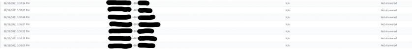

I have a very strange issue on one of my clients phone systems. When toll free numbers call in 3CX is sending a response back to my siptrunk provider of 486 busy here. When I look at the activity log the calls our non-existent but they do show up the call log and just say N/A under the to and then not answered. Please see the below screen shot. I changed the outbound caller ID for my extension on my 3CX phone system to that specific number and it comes through no problem. Is there some type of security block in 3CX that I missing that's causing these to come back busy. This issue just came out of no where. Any insight would be much appreciated. Thank You. Screenshot 2021-08-31 171234.png
The call log looks like the call destination is N/A.
