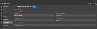

So, is the same DID for calls and SMS? You want that SMS go to XXX extension and calls to that number go to a different destination YYY. Is this what do you want?
If so, using only one sip trunk you can send the DID to a Digital Receptionist for calls and then set that SMS go to another destination.
Check the pic below
