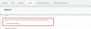

If this does happen, before calling Flowroute, go into the SIP Trunk settings in the "Options" tab and make sure that you are not somehow overriding the IP in the 'Contact' header. The setting should be like this:
