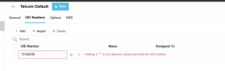

DID is assigned correctly, I believe the problem here is the DID number is not talking with *
see the image attached.

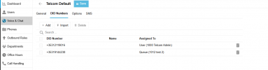

Hi Nicholas,
Yes, I have added +35312119016
Still it done not work.

Ditch the + sign. The INVITE is coming in to 353 as the beginning of the number. You are looking at the diaplay name field, not the actual host part which is what is being used to route the call.
Reactions: rajan
HI Nicholas,
Thank you for your assistance. Everything is working perfectly now. I truly appreciate your support
