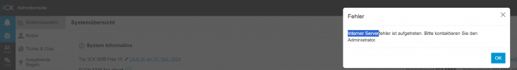

Hello, we i have exacty the same error and the same configuration , 1 T54W as Router phone and W70B as DECT Base. Problem appears after setup the T54W phone the first time.
