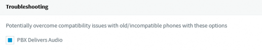

Is the option PBX Delivers Audio enabled, for the extension(s)?
indeed it is enabled.
