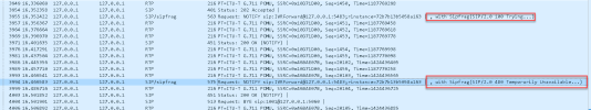

I attach 2 PCAPs. ( In ZIP File )
1 PCAP without Re-Invite, it works.
the other PCAP with Re-Invite, there is a problem

What is happening from a technical point of view is correct. Once you enable Re-invites on the trunks the PBX will send a Re-invite to transfer the call as its doing internally. By enabling Re-invites of the trunks you are telling the PBX that your provider supports this behavior.
From the captures it looks like that your provider does not support Invite messages without SDP and its rejecting the Invite. Invites without SDP are supported by the RFC and are used mostly in transfer scenarios like this one. The SDP will be sent in the ACK message from 3CX once the 200 OK message is received. So 3CX does not do anything wrong here.
You expect the PBX to send Re-invites for hold music but not for transfers. Unfortunately it does not work like that, if you enable the option you need to make sure that your provider supports all scenarios.
For the record we replicated the issue with a supported scenario that does support Re-invites with SDP and the transfer worked fine.
So you have 2 options here, you either disable Re-invites on your trunk or you find a provider that supports both functionalities.
On supported providers we leave the option disabled so the PBX can handle these scenarios properly.
