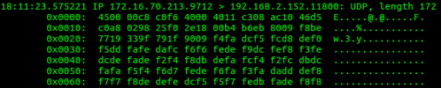

I have captured a network dump in server
like alice's peer RTP port is 9712 (captured from alice's sdp body), then I also capture in server using
Code:
sudo tcpdump -i eth0 udp port 9712 -w s.cap
to see whether any packets from alice to server, proved flow like this
1. why the dest ip is alice's LAN ip (192.168.2.152), but not alice public ip? ( as the contrast, I also captured a successful SIP communication from m$ Azure server, which shows the dest IP is alice's public IP)
2. the direction shows that packets is from 3cx to alice, means the 3cx server is transfering packets from bob to alice, correct?
which in turn means that at least bob's RTP packets successfully received by 3cx first, then 3cx can transfer them back to alice one by one, but no such evidence from capture file between 3cx and bob, why? (which also only got packets from 3cx to bob, like alice's)
thanks y'all
