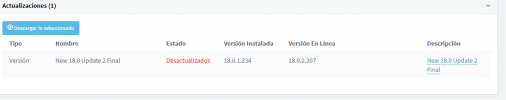

We backed up v16 and uninstalled. We installed the V18 and recovered. The OS is windows 2019. We have another additional problem, we don't know since when but it doesn't make updates.
From dashboard the service 3CXGatewayServices does not start either
