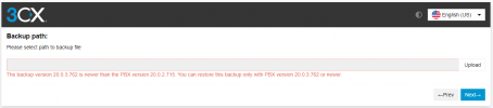

Long story short
Using hosted cloud environment
Host were pushing out Betas as part of their server build and then stopped doing that when we said thats not the best thing to do
Upgraded a clients instance from v18
Instance failed 5 days later
Had backups!! (no decent tech does not have backups)
Error restoring backup as the cloud host no long push Beta out
Looking for the Linux commands to update to Beta, then I can restore and at least get my customers 3CX online
Then I can figure out my next move
Please and thank you
I can see it sitting there, just how to force
Setup as blank using same license and FQDN, update to beta, then upload the backup and restore it over the blank system.
My god that is so simple. Jesus. You sir, are a legend
