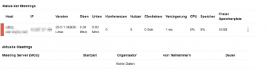

since few minutes we are no longer possible to use our local 3cx webmeeting server.
In 3CX admin are it is shown as green:
in Webbrowser we are shown: Ups, a error occured
In 3CX Smartphone App it is shown: "TLS error mcu"

After a restart of 3cx webmeeting server, the server is shown red in 3Cx admin.
The server itself is online.

But unfortunately it keeps showing red in 3CX PBX.
When we use 3cx webmeeting self check it shows: "No OnBoard MCU Available. Please try again later"

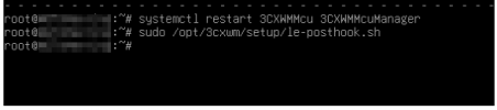

Please run manually (as root) the post update script:
/opt/3cxwm/setup/le-posthook.sh
This will update the certificate files and restart services.
We run the script. There was no error message or other message:
Unfortunately it's still not working:

Oh, apparently I had to threaten the VM to delete it, now the icon in the PBX has suddenly changed to green and meetings are possible again! SslLabs now also shows the new SSL certificate.
