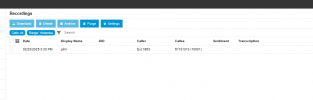

we are using a V20 u4 pro license and following the instructions in https://www.3cx.com/docs/manual/google-speech-api-v2/ we set up a connection to a google bucket and as per screen shots attached, "appears" to be generating files in the bucket for transcription , but we don't see the transcriptions in the recording area (2nd screenshot ) i have not detected any errors in the log file,
Can i ask the community first if i am missing something obvious /doing something wrong , before i go and pay for a ticket to help resolve it :)
thank you for your help

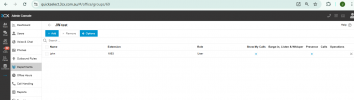

Hello Nicholas thanks for the quick response , from the attached screenshots i believe i have the right boxes ticked. , when i said there were no errors that was referring the log on the 3cx dashboard, but is there any other place where their might be more detailed logs that i can check in 3cx to make sure Google is doing its part correctly,
