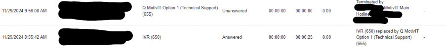

I can confirm that agents are logged in and their status is not set to DND while we receive the email for lost call queue. Our maximum queue wait time is set to 1 min. but when checking the report, the call time lasts only for 25 to 30 seconds.

Hi @NicholasP_3CX the call time didn't exceed our call wait time which is 60 seconds. when I checked the reports, calls only lasted 25 to 30 seconds. Also, once the caller selected Option 1, the call was terminated.

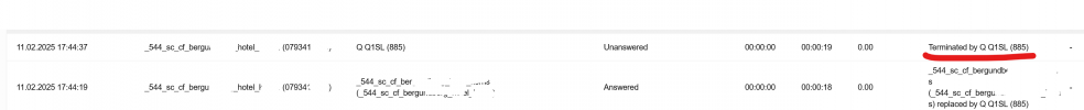

We have a similar problem with a 3CX V20 20.0.4.487, the latest version. Very simple 2 queues - queue Q1SL - longest waiting time, signaling 12 seconds, max waiting time 60 and "destination if not accepted" Q2SL. But according to the call log, the caller never gets into the second queue Q2SL - according to the call log, the first Q1SL drops the call after a few seconds? What can trigger this, that a queue terminates the call? Regardless of whether agents are logged in or not, at least the caller should end up in the second queue and not be terminated after just a few seconds.
Please take a look at the logs and the screenshot? Am I misunderstanding the purpose of a queue or is this a bug?
It says in the logs, "Caller has dropped call" but when a caller hangs off, i would see in the call raport terminated by caller number?
Because the customers who calling says, they did not hang off.
2025/02/11 16:55:10.993|0007|Info| [_3CX.QueueManager.PollProcessor] Statistics:
Poll processor state:
=Normal requests:
=Total: 0 requests / 0 active
2025/02/11 16:55:20.995|0007|Info| [_3CX.QueueManager.PollProcessor] Statistics:
=Normal requests:
2025/02/11 16:55:27.692|0005|Info| [_3CX.QueueManager.CallsQ] Call(278074) has been started
2025/02/11 16:55:27.692|0005|Info| [_3CX.QueueManager.QCallTrack] 278074,Created,0782522305,_544_sc_cf_bergundberg_hotel_kerns:
2025/02/11 16:55:27.692|0005|Info| [_3CX.QueueManager.QCall] New incoming call to Q:885 from 07825xxxxx; qcid=278074
2025/02/11 16:55:27.692|0005|Info| [_3CX.QueueManager.QCallTrack] 278074,PBXCallId,33604
2025/02/11 16:55:27.692|0005|Info| [_3CX.QueueManager.QCallTrack] 278074,Waiting
2025/02/11 16:55:27.692|0005|Info| [_3CX.QueueManager.QCallTrack] 278074,CallerInfo,078252xxxxx,_544_sc_cf_bergunxxx_hotel_xxx:
2025/02/11 16:55:28.193|0007|Info| [_3CX.QueueManager.QCallTrack] 278074,Polling
2025/02/11 16:55:28.193|0007|Info| [_3CX.QueueManager.QCallTrack] 278074,Selected,[168@885]
2025/02/11 16:55:28.193|0007|Info| [_3CX.QueueManager.QCall] Poll is started for QCID=QC:278074[07825xxxxx->885]
2025/02/11 16:55:28.193|0007|Info| [_3CX.QueueManager.QCall] Polling: QCID=278074, agents=[168@885]
2025/02/11 16:55:28.198|0005|Info| [_3CX.QueueManager.QCallTrack] 278074,DialAgent,885.df9b33082f3244d39ca177a637d477c4,168,168
2025/02/11 16:55:31.194|0007|Info| [_3CX.QueueManager.PollProcessor] Statistics:
=Normal requests:
* PR:278074 @ Q:885 [Active/1]
=Total: 1 requests / 1 active
2025/02/11 16:55:34.499|0005|Info| [_3CX.QueueManager.QAgent] Agent QA:168@885 has dropped call 278074 before servicing started
2025/02/11 16:55:34.499|0005|Info| [_3CX.QueueManager.QCallTrack] 278074,OutCallEnd,885.df9b33082f3244d39ca177a637d477c4,487,Cancelled
2025/02/11 16:55:34.502|0005|Info| [_3CX.QueueManager.QCallTrack] 278074,InCallEnd,487,Cancelled
2025/02/11 16:55:34.502|0005|Info| [_3CX.QueueManager.QCall] Call(278074) has been terminated (reason: Abandoned)
2025/02/11 16:55:34.502|0005|Info| [_3CX.QueueManager.PollRequest] Poll is terminated, reason: Canceled (Caller has dropped call), QCID=278074
2025/02/11 16:55:34.502|0005|Info| [_3CX.QueueManager.QCallTrack] 278074,QCallEnd
2025/02/11 16:55:34.502|0005|Info| [_3CX.QueueManager.QCallTrack] 278074,Q.885: [0782xxxxx] (hist_id: b8afb8f594010000_33604)
Time: 11.02.2025 16:55:27 - 11.02.2025 16:55:34 (00:00:06.8102421)
Waiting: 00:00:00.5014749
Polling: time: 00:00:06.3086657 (1 rounds), agents dialled: 1, rejected: 0, timed out: 1
Failed: Caller dropped the call
Result: WP
