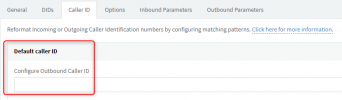

The main trunk number can be used for some outbound calls as your caller ID going to the provider. Mu suggestion would be to change the main trunk number if that is what is required and add your current main trunk number as the caller ID of the trunk to avoid any issues.
You can do so by accessing your trunk settings / Caller ID tab and add it under the Default Caller ID field
