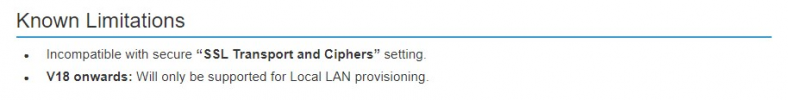

Since only local LAN is supported I guess for provisioning in v18 and I don't want to pay $400/m for an azure virtual gateway, how do I manually set these devices up to use an SBC or STUN?
Thanks very much
Actually @beezsk is right, the Snom PA1 from v18 onwards is only supported in a LAN configuration: 1636704348665.png
That said, as this is mostly due to do with limitations in the ciphers being used, theoretically it could work if you download the configuration manually and upload it to the device. Something similar was discussed here back when it was supported for remote configuration: https://www.3cx.com/community/threads/provisioning-snom-pa1-problem.58820/ . Even if this does work, it would also mean that you will not be able to reprovision the device via 3CX, upgrade it's firmware, or perform any tasks that rely on https communication whatsoever.
