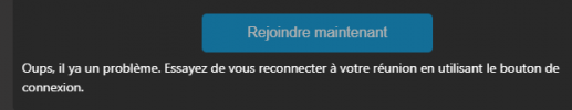

Hello All,
We recently changed from v16 to 18, but now we are getting the error "MCU Connection Failed (0x0020)" every time when we try to connect to a WebConference

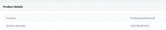

Hi this is the version, we have been using webclient on chrome and edge, as well the app desktop.

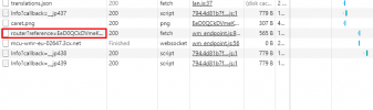

Once you do that, open a WebClient, go to "Meet" and before you press the "Join Now" button, press F12 in Chrome and switch to the "Network" tab. Then press the "Join Now" button.
Right after the highlighted entry below, what do you see when it doesn't work?
Do you get a "mcu-wmr-XX-XXXX.3cx.net" request?

For the debug mode, here is what I captured on a 0020 error :
1649404983939.png.
The entry "Info?..." get an entry every 1 or 2 seconds.
View attachment 29360.
Thank for your support
What seems to be happening is that your 3CX Server can't get the list of MCUs from the 3CX WMR server.
The high level of how this works is that each time you Create/Join a meeting, the 3CX Server queries wmr.3cx.net and downloads the list of active MCUs, then chooses the best one and tells the WebClient to connect to that one.
By the time you are not seeing a "mcu-wmr-XX-XXXX.3cx.net" request, your server is probably never getting this list.

For others reading this, what may be happening is that your PC where the 3CX WebClient/Desktop App might not be resolving the MCU FQDN correctly.
What you can do to check this is:
  1. Press F12 in Chrome or the Desktop App and go to Network
  2. Click on "Meet" and press "Join Now"
  3. In the Network Panel find the "router" connection and right below you should see the MCU address you are connecting to.
  4. Now do 2 things:
    a) From your PC, open a command prompt and type: nslookup <MCU address>
    b) Go to https://toolbox.googleapps.com/apps/dig/ and paste the address here as well and resolve it
  5. If the IP that is resolved isn't the same in both places, most likely your Internal DNS Server is caching the wrong IP or for whatever reason, returning the wrong result.
