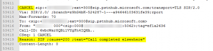

With the v18 Teams integration, I'm seeing an inconsistency when it comes to the call log: Teams will regularly mention a call as missed even though it got accepted.
After reading this: https://docs.microsoft.com/en-us/microsoftteams/direct-routing-call-notifications - I wonder if the "REASON: SIP; cause=200;text”Call completed elsewhere”" message is properly implemented, or if this requires additional configuration on my side in either Teams or 3CX.

Hi!
I just double-checked our logs and when the 3CX Server wants to send a CANCEL request because another endpoints that is registered on the same extension answer the call, what we send to Microsoft is this:
This is a snippet from the logs I tested with to ensure we send the correct thing.
Also I should note that I tried this scenario on a V18 U3 installation (that's where the log is from...) and in my case it does not appear as a missed call.

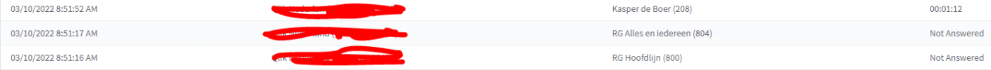

However, literally few hours before:
So what happened here was:
- The call came in on the public number
- It got forwarded to the call group (Alles en iedereen)
- Then Kasper took the call.
This is the setup every time. Call comes in, gets forwarded, someone picks up. Only sometimes you see the "hops" in the call log, and sometimes you don't. So I feel this is an issue in 3CX in some way as well.
When the call transfers, it somehow registers itself als not answered.
EDIT: Mind you, the 10th was before I updated to 18U3. The difference between the two logs is the first one was a direct number to a single call group, the other one is call to a generic number, which then forwards to a call group. Hence the multiple hops. I wonder if it's possible to tag a call as not missed when it's forwarded to another call group.

Some additional information. After reading: https://www.3cx.com/community/threads/ring-group-missed-call-notification.82243/ - I figured it's intended that a Ring Group is flagged as unanswered, when it forwards to another group.
However, in the above screenshot, this one to be exact:
https://www.3cx.com/community/attachments/1647257392574-png.28672/
This is the situation:
- There is a Ring Group called "Hoofdlijn", which can be called directly.
- After 1 second* (if none answers), it forwards to Ring Group "Alles en iedereen".
- Both are set to a Ring All strategy.
* It's set to 1 second because our receptionist is on leave.
This means if you look at the screenshot and go by the information in the forum post:
- The incoming call of 1 second is intended to be flagged as missed in "Hoofdlijn".
- The forward to "Alles en iedereen" is NOT intended to be flagged as missed, since Kasper answered the phone there.
So, something is clearly going wrong somewhere in 3CX.
I read that moving over to a Call Queue might fix it, but we answer the phone within 1 minute all the time, so I don't really see the benefit over a Call Group. Are there any downsides? We're also not a support desk, a client calls and immediately gets to speak to a developer.
