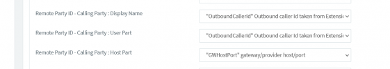

The trunk providers support UDP and TCP which is totally fine. Here is the trunk outbound parameters
Let me know if you have any suggestions so I'll try.
@leejor I tried to call without rules and the same issue, so I guess the Outbound rule that I configured is needed and fine.
Your outbound parameters are the ones in the generic template which might not be compatible with your provider. I would try to remove the Remote Party-ID headers and set them to default value and try again. Of that fails then you will need to speak to your provider for the best settings to use.
