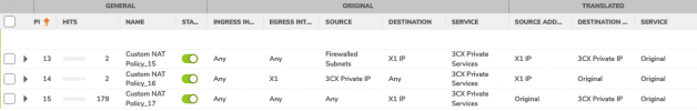

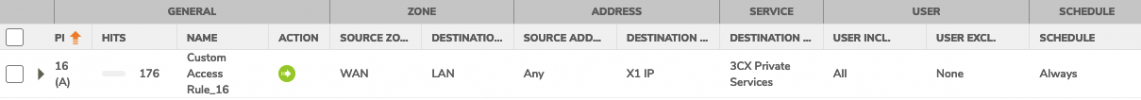

Hello and good day peeps. I am having issues and need some assistance with getting the FQDN to resolve the 3CX server private IP, so it will remove the "red error message" on the admin login landing page. Also with getting a good clean firewall check from 3CX. I have combed through all of the guides and forum posts that deal with or mention "sonicwall" settings and getting a good firewall check and setting up a "lookback" policy for the FQDN. I have created all of the settings manually and by using the "wizard" in the Sonicwall, but nothing seems to be helping. I know it is possibly something stupidly small, but I'm at a loss and need some help please. Check out the screenshots of how things are set up currently. Thanks
Update, I was finally able to get most of the "firewall check" passed, all except for a couple of things. One being the SIP ALG "failed", yes I do have the "Enable consistent NAT" option active along with the "Enable SIP Transformation" disabled. The other thing is "3CX SIP Server" failed, but everything works good.
Also I can not get the FQDN to translate to the IP of the 3CX server, no matter what I do. Like I mentioned everything passes and seems to be working correctly except for those 2 things that have failed. I can log into the admin console using "https" and the ip of the 3CX server, but can not access using the FQDN.
Any help and/or guidance would be greatly appreciated.

Thank you for the reply. I have tried to do option #2, but no success. I believe the "terminology" for our firewall would be "DNS Split" or "NAT Loopback". I have tried to follow the guides from the forums along with the guides in the KB section of "Sonicwall", but nothing seems to get it working. I may reach out to "Sonicwall" support to see if they can help me with the "DNS Split" or "NAT Loopback", so the FQDN error will go away on the admin login landing page. Any other suggestions from anyone is greatly appreciated. Thank you guys for all of the help so far.
