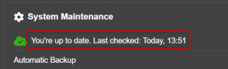

In the dashboard, when is the last check? In your screenshot it shows a week ago.
Press anywhere within the highlighted area. You should be taken to the updates page and see it searching

In the Dashboard, 'System Maintenance' shows as Up to date (Update_status_in_Dashboard.png). On clicking on it, Update screen is shown, but does not show ZoHo download option (update_screen.png).

From your screenshots we can see you're in Update 4, so that explains the issue. The template will be available for U4 users when the final release is out.
