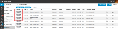

So this works - and you have a screenshot example. Here I do a call logs report and I select "This Year"
For this instance the update was made last last week in preparation for yesterday's release.
You can see that yesterdays calls are displayed together with the old call (from the old tables)
