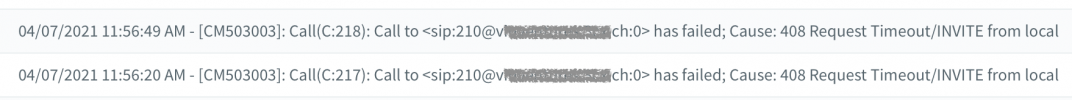

Attached is the log when I tried to reach the number - maybe you will see there something I cannot see. (In the log I was calling from a number ending 243, store number is ending 049)

I did call the extension directly:
If I call internally the Extension (210), there is our system automatic message that the store employees are busy and it will be forwarded to our Customer Solutions team.
But in both cases (calling the number from outside or extension 210 internally) I see the same thing in the Log (see attached)

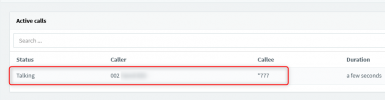

  • From the DECT Extension, try calling *777. This is the Echo Extension. When you speak into the handset you should hear your voice. Does this work?
  • While you have a call to *777 active, go to the Management Console --> Dashboard and click on "Number of calls in use". Do you see the call there?
  • In the Management Console --> Phones, do you see the DECT STUN devices with the correct Public IP listed?
So we did the test and we could hear the Echo and also the call appeared in the Active calls on the Server.
And yes, there is the correct public IP address of the store next to the phone

Mostly on speculation I would suspect the firewall at the remote site most of all, due to this log:
But it's not very clear yet where the issue is exactly because you said you already checked the firewall. It might also be the ISP modem after the firewall that may be doing something you are not aware of, we've seen this happen on some cases where the modem blocks incoming SIP or blocks port 5060 or runs SIP ALG which can interfere.
