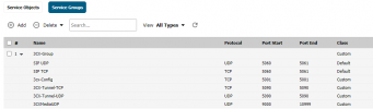

Since port 5090 (3CX Tunnel port) failed along with SIP and the RTP ports your app won't be able to register over the internet.
Your firewall rule looks like it only allows the port forwarding from source IP 109.x.x.x when it needs to be all.
Here is rule and service group on my SonicWall for comparison
Service Group:
Rule:
For SonicWall there is a NAT Policy as well but just sharing the basic setup of the rule.
