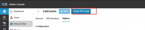

Regarding your question, try switching on the Call monitor for the calls to the extenion used to test, and also test the SIP trunk configuration with your SIP trunk provider.
I test the SIP trunk first to ensure there are no issues, then monitor the connection quality to check the results of a test call.
I don't have the “Check SIP Trunk” button and have now activated “monitor connection quality.” Where can I find the result?
The results of the call quality monitor can be found in the call log reports or event logs.

addendum for others:
That’s correct. In the current 3CX version recommended for production use this option does not yet exist. Charles is a few weeks ahead of the timeline ;)
