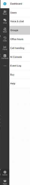

how i enable the new default of v18? I installed this system just a few days ago, with V18 (update 19, build 23) but i access with the usual web management console, where i didn't find "departments".
So departments will be created from the Web client Admin console (as system owner) :
also in there, you can adjust the settings, and then in the Management console >> Inbound rules , you will have the ability to send the call to the group
