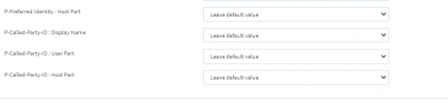

So you will need to assign to each user of that department, the caller ID of the department, or have the outbound rule per department where outbound caller ID will be the one you need.
Dear I have asin the caler id But still Not Working with user and outbound policy also
So in the trunk settings, you will choose variable (for the SIP field that your trunk expect the number to be in) and have it set as :
Did you verify in which SIP field your provider expects the number? Do that and then put the settings accordingly.
