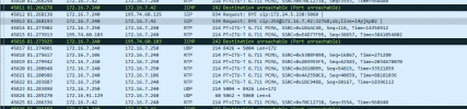

the wireshark traces looks like this
looking at the bye command i see the following, im reading that from some reason 3cx is sending an icmp to the handset and then to the sip provider and not getting a response so is dropping the call.

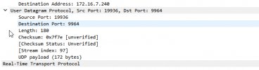

The fact that some RTP are not reaching the endpoint RTP port has to be checked internally.
However the 501 that is coming from the firewall needs to be checked.
As a first step ensure that the firewall checker is passed successfully.

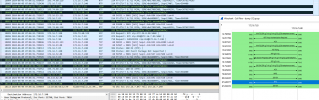

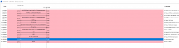

the BYE message is linked to this in the dump file
So whose IP is this, is it a provider IP?
172.16.7.83 is the yealink phone, 172.16.7.240 is 3cx , 195.x.x.x is our sip provider
From the screenshot you show, PBX sends bye to the phone, but there is no indication of the provider, and maybe you are not selecting the provider part of the call. Do that and check if the provider is sending BYE, and if that's the case, maybe you should check with them further.
