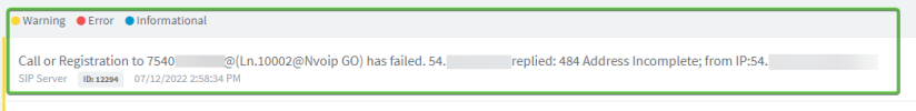

My rules I have for outbound, the first two works great. Then I added my second two, these outbound rules do not work as I have tried prefixes 7,8,99,88, etc. all same results.
Incoming calls no issues just outbound. See the last screenshot for my event log as they are routing via the wrong SIP.
Any help is greatly appreciated.
Here I have my rule when it sees a 7 prefix from my extension 100 then it should use the anveo SIP and strip the 7
Here you see in the logs where it sent the 7 prefix even when I said strip and you notice that it is going out the wrong SIP (Nviop GO) rather than the (Anveo) SIP.
I moved the order and seems like it works if I order by the prefixes 5,8,9,none
