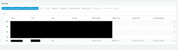

@ChrisC_3CX we have installed and SBC and the SBC is connected and on our 3cx please see the image
We tried provisioning the phone to work and it failed it would not even connect this time. I have watched and read the SBC guide and it states it has no firewall requirements. If the SBC is connecting but the phone will not provision what should I be looking at next

Please try the following and let me know what happens:
Before proceeding, double check that the IP Phone is running the latest 3CX Supported firmware mentioned here: https://www.3cx.com/support/phone-firmwares/
1. Factory reset the IP Phone, once it starts up and reaches an idle state, access the Management Console and go to Phones. Does it appear in the list? If yes, does anything happen after assigning it to an extension? Check to see if the IP Phone provisioned(extension and name are shown on the screen).
2. If it does not provision as per step 1, try using the Manual Link Provisioning method. Does it provision this way? Again, check the IP Phones screen for the extension number once you are done(it might take a couple of minutes to provision).
3. If step one fails but step 2 succeeds, factory reset the device and follow step 1 again while running a packet capture on the 3CX SBC host and on the IP Phone. After you have assigned an extension to the IP Phone, wait for approximately 30 seconds and then stop the packet capture on both the SBC and the IP Phone. Then check the packet captures for SIP traffic between the IP Phone and the 3CX SBC, does it exist on both captures?
